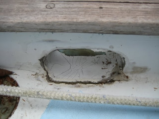

I'll take some pictures of the underside this afternoon.  They are compeltely glassed through holes, pretty much a tube of fiberglass going through.  No leaks there, but as I mentioned the gelcoat cracks badly.  Here is the port side one, it is the most cracked:
Its just one of many areas on deck that need repairing before I paint.  The glass going through the bulwark is solid though.

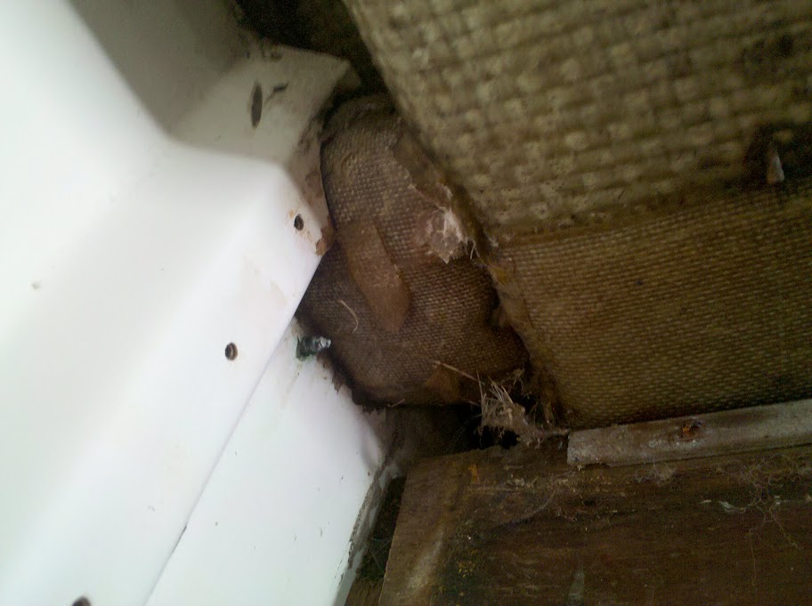

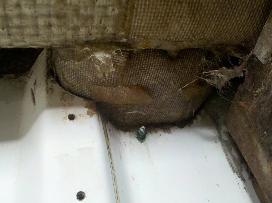

Here are two pictures of the starboard hawse hole from the inside.  You can see that it is just a fiberglass tube going through the bulwark.

July 21, 2010 - 10:45 am
I still like the bronze hawse pipes but I also like the fully glassed tube.. A combination of the two would be super strong and totally forever waterproof 🙂
