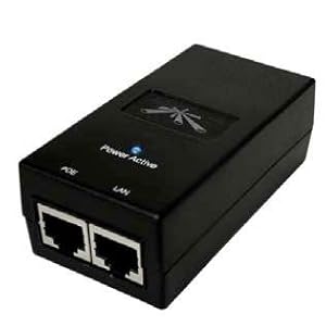

Ubiquiti POE-24 Power Over Ethernet 24W (this is a unit that can be plugged into a 120volt wall outlet. it is much cheaper than the 12volt to 24volt unit that I had on hand and we setup off of their 12volt power supply that was powering the marinas VHF)
http://amzn.to/29gckF4
right now this is around 17 dollars

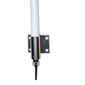

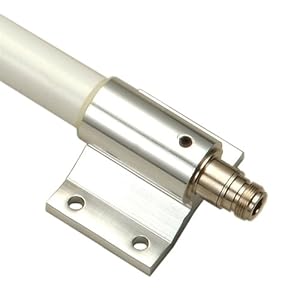

this antenna is slightly different that what I used as it has a base that includes a 4 hole mount. I will be screwing this to my mast at the top. Also it is a 12db.. not sure that this will be a good thing but I am going to try it.. it gives a much flatter radiation pattern that will extend farther but that will have a dead zone close to the boat as it is so high up. If it was lower down it wouldn't be an issue. 8 db antenna is probably better but I wanted to play with this one.
so you just screw the bullet access point to the base of the antenna and mount them. Then run an Ethernet cable from the POE injector to the base of the bullet unit. This carries your power for it and your data. You don't lose any signal strength this way with long antenna cable runs. Then you plug your dsl directly into the other Ethernet port on the POE unit
The POE unit that I used is a 12volt to 24volt unit that I was going to wire into the boats 12volt system.  It was 39.95
(TP-DCDC-1224) 9-36VDC In, 24VDC Out 19W DC to DC Conv / POE Ins
The TP-DCDC-1224 DC to DC converters offered by Tycon Power Systems are a low cost and high reliability solution for those requiring 24VDC Power Over Ethernet voltage from a 12 or 24V battery system.
They have an integrated POE injector to apply the regulated 24VDC to the CAT5 Ethernet cable. The input voltage must be between 9VDC and 36VDC.
They accept data-in to a shielded RJ45 Jack and provide data-out and POE power on the shielded RJ45 output jack.
They work by supplying power on the unused Ethernet pins 4,5(V+) and 7,8(V-).
They have various protections for surge, short circuit and overload. The units have power output of 19W.
