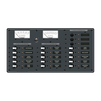

I'm thinking of replacing/moving ours too. The Blue Sea 18 switch panel with gauges seems to be a good fit according to the approximate dimensions, with a little room to spare for another instrument or smaller secondary panel. Although they make combination panels with AC/DC integrated I'm going to keep ours separate to avoid any "crossing of streams." Ebay has some pretty good deals right now.

I went Blue Sea, I like the products.
The panel i used, didn't cover the hole from the original, so I made a teak frame for it to live in. I also incorporated a hinge and latch as to make access easier.

I prefer digital meters myself.  The analog ones I have on the boat are so out of whack these days I don't trust the readings at all.
The panel you linked doesn't have a built-in battery control selector so you'll need to add that.  This is one I'm eyeing pretty hard:
https://www.bluesea.com/products/8690/Dual_Battery_Bank_Management_Panel
and then combining it with this...
https://www.bluesea.com/products/8264/Traditional_Metal_DC_Panel_-_24_Positions
 The original configuration for the DE38 (at least mine) has a few things I disagree with, and from what I understand isn't to ABYC standards.  There's two things I don't like.  Firstly, the original configuration had a two position battery switch and if I'm not mistaken, both runt he house lights as well as the engine.  Sure you can run only one bank at a time, but I always understood that you should separate your electrical system separate from your house bank and isolate the two systems.  Having house+engine in one can leave you without the ability to start the engine in the boat if needs be.  The first product lets you easily rig up two separate banks and combine them for emergencies.  Secondly, the stock setup seems to have the bilge pump wired into the main panel.  That's great, but when you leave the boat you have to either leave your main switched on or leave your bilge pump off.  I believe that current ABYC standards mandate that your bilge pumps should be wired on a separate circuit directly from the battery banks so you can shut the main off but still leave the bilge pumps on automatic mode.  The first product lets you solve both problems in one fell swoop.
I guess, lastly, because of that if you leave your boat on anybody can just walk up to the boat and drive away.  I know security on sailboats is pretty minimal, but I feel like you should be able to leave the boat, turn off the main (so somebody has to at least break in the companion way), and not have to worry about your boat sinking if you're leaving it unattended.
