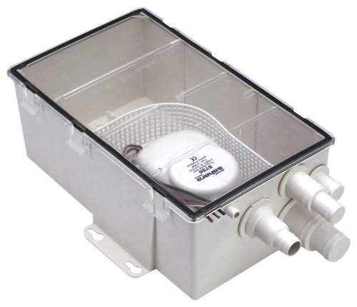

We're troubleshooting our new DE 38 ( I know, oxymoron; new DE 38..) and the idea that all the greywater: shower and sink, go into the bilge and get pumped out sounds like a greasy, soapy, scummy mess in a place I can't clean. I've seen self enclosed grey water catchment boxes that come with an automatic bilge pump. Shower and sink go in, water is jettisoned through a through hull. The unit has a lid that opens to allow cleaning of the mesh screen.
Anyone ever use something similar? At least for the shower? I can't imagine that system doesn't foster a smell from the collection down there.

The shower on our boat also drained into the bilge when we got it. Ours had a pump under the floor that sucked water out and pumped it aft. It was very unreliable and got plugged up and stopped for every 15 or 20 minutes of operation. We put in a dedicated bilge box with float activated bilge pump in it under the floor near the hatch in the floor of the vberth. We then ran the shower to that and sealed off the lower chain locker from the rest of the boat with a 1 1/2 inch through hull. We ran a hose from that under the vberth and to the bilge box. While we had A/C still on the boat we also ran the condensate line to the bilge box. This has worked exceedingly well for 3 or 4 years now and the boat stays as dry as a bone from all those water inputs. We ran the outflow line from the pump in the bilge box to a above the water line through hull on starboard at the top of starboard hanging closet in the vberth. We used a half inch line with a back flow preventer right off of the bilge box and a anti-siphon fitting in the top of the hanging closet. This setup has been maintenance free for us for the last 3 years.. The bilge box has a rough filter in it that the water flows directly into on its way into the bilge box. This strains out large stuff before it can get to the float switch or pump.

Did you use a prefab bilge box/pump and if so, what kind? I can't imagine there's many choices.

On our boat there is a large through hull for the head and right beside it another maybe 3/4 inch one for the sink. we have gone to a composting head so the large one is no longer used.
Our sump/bilge pump unit forward was a commercial unit. We bought it at west marine for about 100 dollars. Way over priced for plastic box but I didnt have the time or patience to glass in a permanent unit and add a strainer and filter to it. I'm not sure the model or brand.  It has worked well so far over the last 3+ years.
here is the product we are using from west marine..
one from west marine
Sad to say the reviews on durability are really bad on west marines website. Ours has worked well. I did a short search and here is one from attwood that is 30 or 40 dollars cheaper with a similar size pump that has some really good reviews. Same basic thing as what we have. If ours died I would probably get this to replace it with.
 Rule model

I bought one of the knock off ones, I believe it was a Sea Dog version, but basically the same animal.  There are a few more options out there, but I think the mini tank is the best.   I'm probably going to plug the ice box ones, ( one permanently as it's now my freezer, the other with a removable plug)
